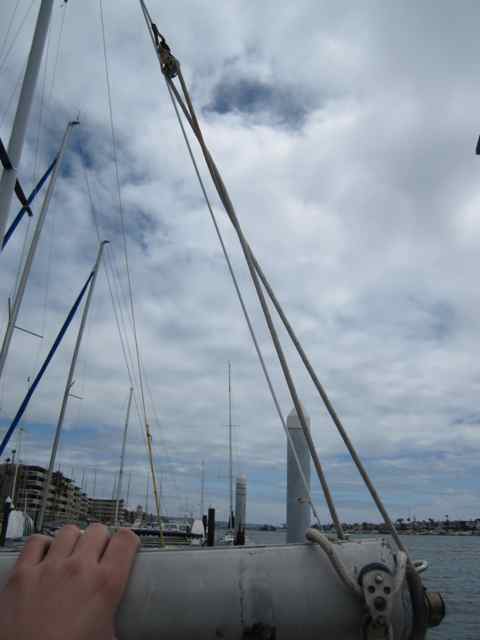

here's an example
topping lift.jpg (19.42 KiB) Visad 22647 gånger
the wire with the block is attached at the top of the mast just 10 cm below the masthead using a 2 screw clip blacket. admittedly, the screws made removing the masthead for antenna wiring more difficult. on end of the lifting line is tired to a clip on the side of the boom using a stopper knot, the other end runs through the an eye and jammer. make sure there is a stopper knot at this end as well.

This is interesting solution. Thanks for the photos.
I have just made the simplest topping lift: riveted an eye some 3 cm below the top of the mast at left side (close to the attachment of the back stay) with small roller. The line is fixed at the cleat at the left side of the mast, some 1 m above the deck. The cleat seams to be original. After adjusting the right length, the topping lift does not need to be adjusted more. The disadvantage of this solution is, that the line is scratched by the metal plate at the head of the main sail when the main sail is lifted with the wind from starboard. Than the topping lift line remains at the right side of the mainsail. So it will probably not survive more than one season.
